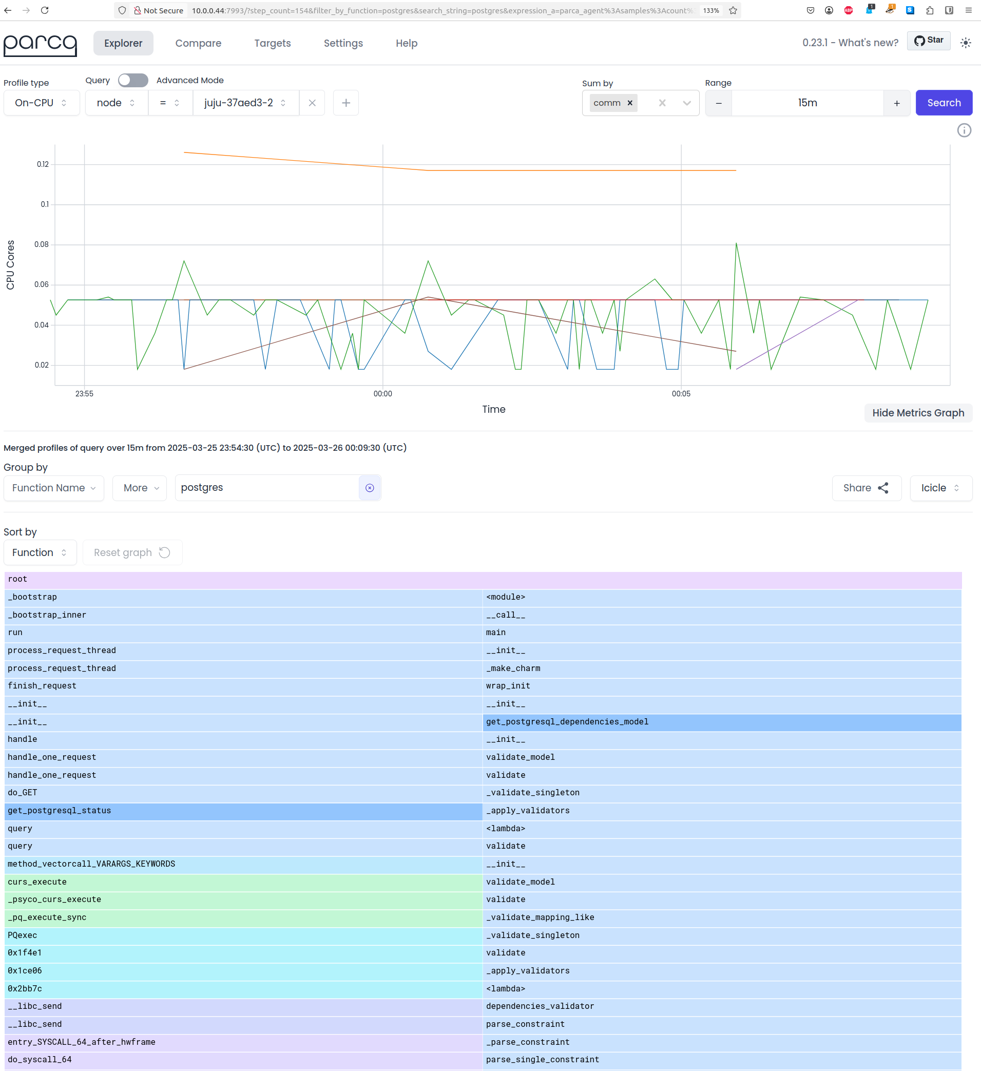

View profiles
After the backend setup is complete, the profiles for the machines where the PostgreSQL units are running will be accessible from the Parca web interface.

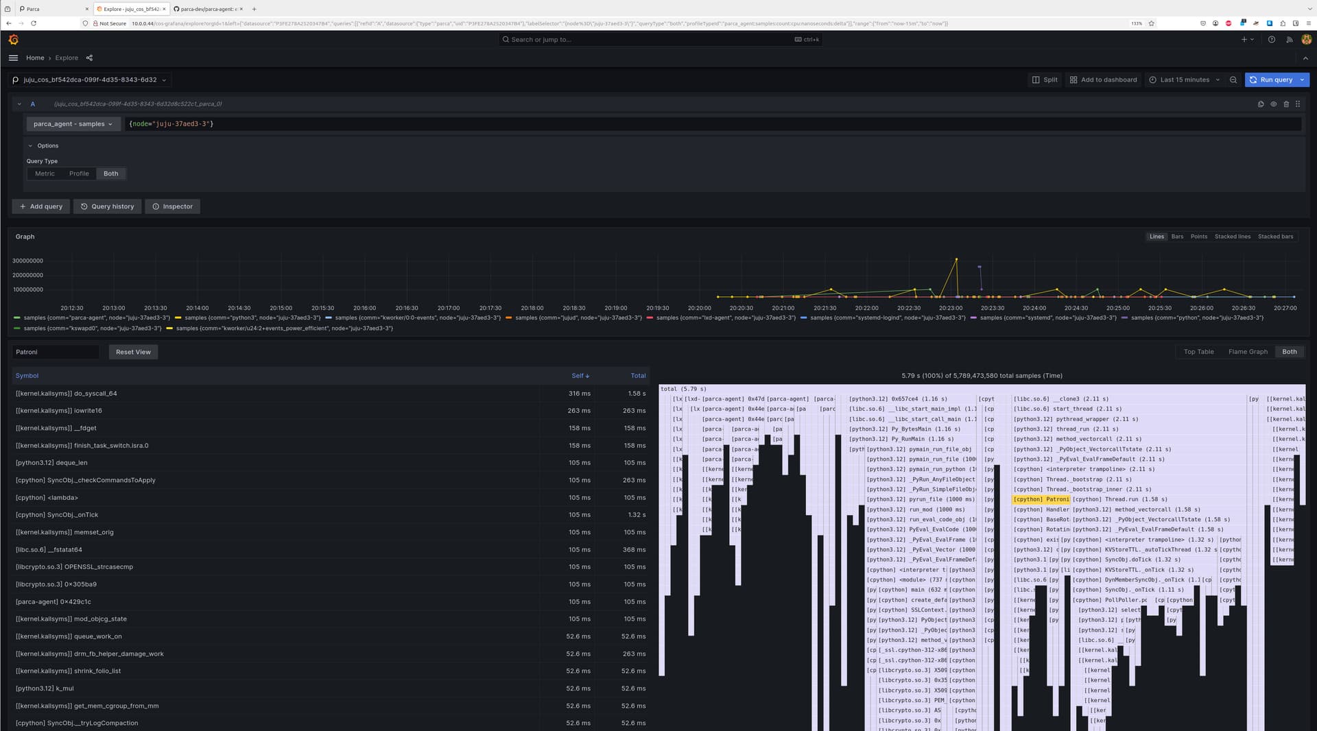

If you are running Charmed Parca K8s, you can also access the link for Parca’s web interface from COS catalogue (juju run traefik/0 show-proxied-endpoints in the K8s model where cos-lite is deployed).
Furthermore, if you have cos-lite deployed, you can use Grafana to explore profiles under the Explore section with parca-k8s as the data source.
great write-up! I’m wondering, can you use profiles generated this way to optimize queries? or is this too low-level?
I’m not sure if it would be of help with recognizing which queries to optimize. However, if a machine’s CPU (or other profiled resource) is too high, a PostgreSQL developer would be able to pinpoint exactly what component of PostgreSQL is consuming said resource.
To be able to determine which queries to optimize, tracing through Tempo looked more promising - but we would need a good tracing/OTel PostgreSQL exporter to use (pg_tracing by DataDog is currently an unstable and experimental product)
