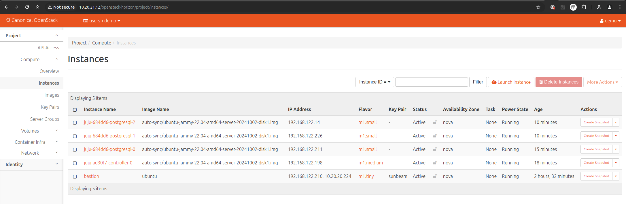

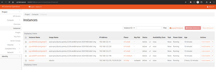

The image below is an example of the OpenStack dashboard view (bastion + juju controller + 3 mysql nodes):
