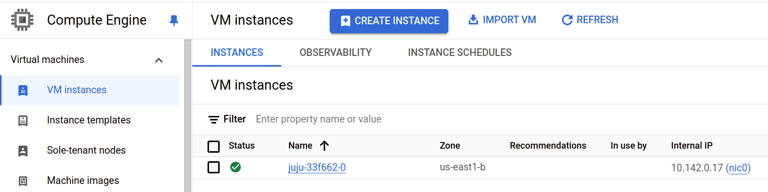

You can check the GCE instance availability (ensure the right GCloud project chosen!):
