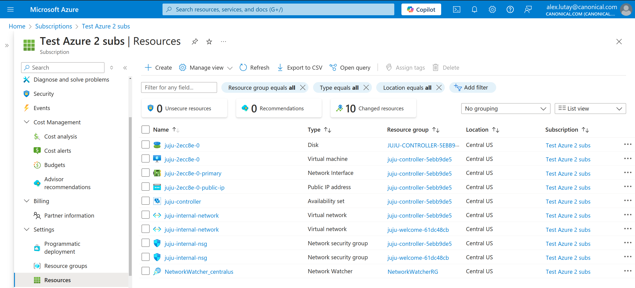

You can check the Azure instances availability:
