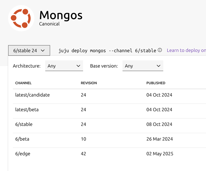

Thank you @adityagoel28 ! would it be possible to remove the latest track?
Do you want to delete the latest track?
Yes, please. This was published by mistake.
Hi, I just checked and I don’t see the latest track. I can only see the track 6.
Can you please confirm.
I just checked and it seems the latest track is always present by default. It is not possible to delete or unregister the latest track.
But for your use case, you can close the latest track (i.e., unpublish revisions from it) using the charmcraft close command and it won’t be visible on the charmhub revisions page.
