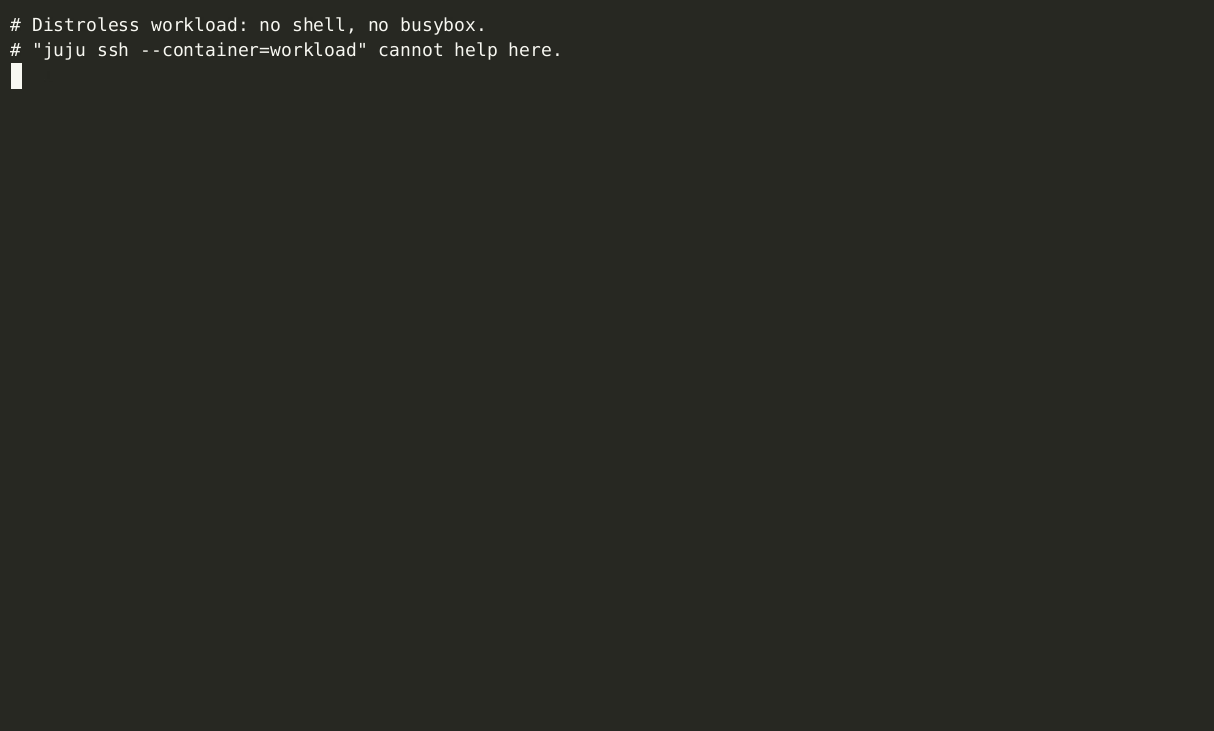

scene2
It’s simple to use, just snap install or uv tool install, and point it at a unit. It’ll drop you into a familiar feeling shell of the first workload container (you can select other ones if needed). As well as common shell commands and functionality, the Pebble commands (services, notices, plan, …) are there as first-class citizens.
(As seen in the image above, you can also use --command to run a single command, integrating it into whatever other scripts you have.)
