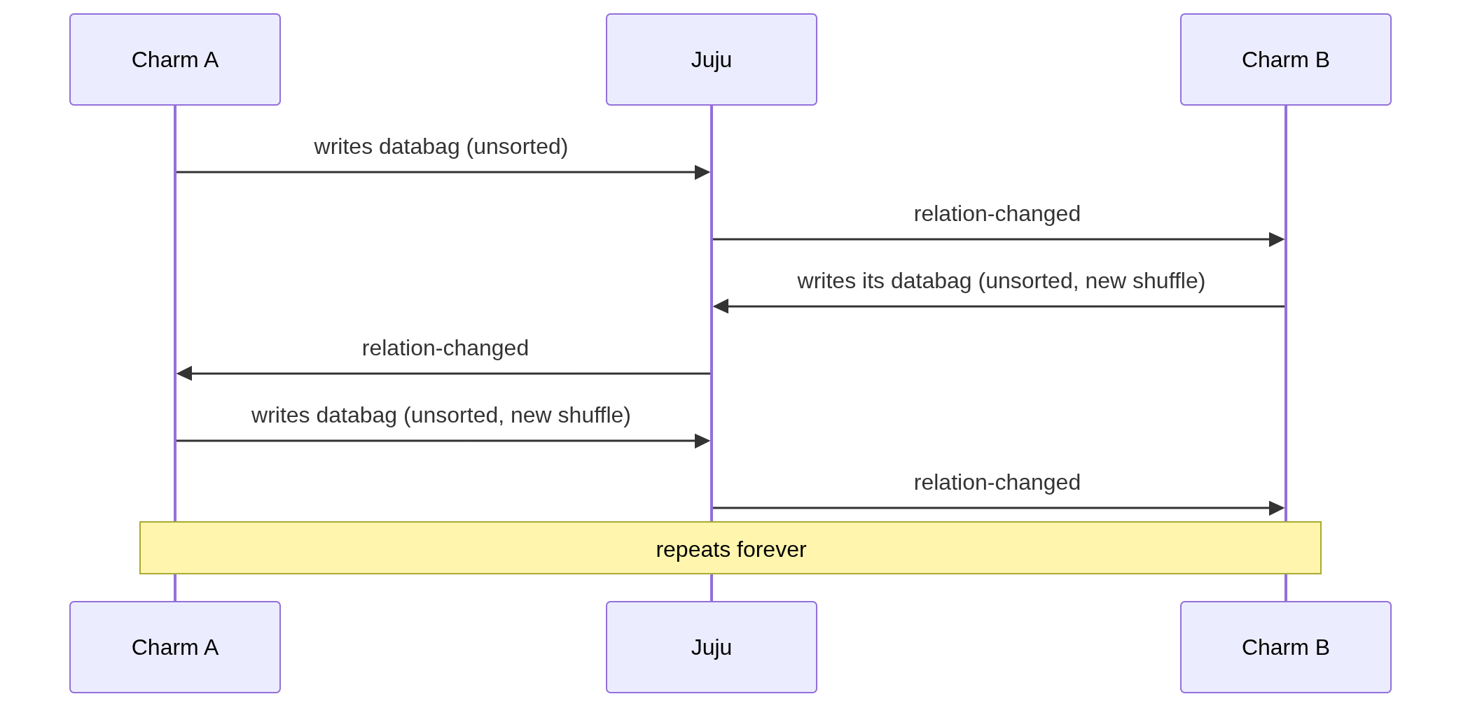

The Ping-Pong situation
Picture 2 charms on either side of a relation, both doing this:
A writes its side unsorted. Juju sees new bytes and wakes B with relation-changed. B reacts by republishing its own side (also unsorted and a different shuffle than last time). That flips A’s view of the relation, which wakes A, which republishes again in a new order… and round it goes.

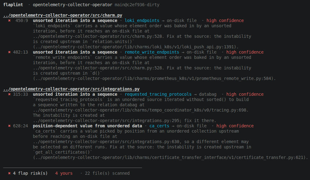

Output from running against canonical/opentelemetry-collector-operator
Every one of those four is the value born in the charm’s own code (src/charm.py, src/integrations.py), then followed all the way through a relation library it doesn’t own (loki_push_api.py, prometheus_remote_write.py, tracing.py, certificate_transfer.py) before it’s flagged at the write.
