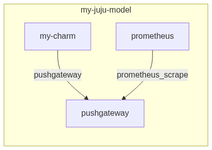

A. Using send_metric library method
The requirer side of the Prometheus Pushgateway library provides a send_metric() method so it is possible to easily instrument an action in a my-charm to send metrics.
Let’s say we have the following charms and relations:
$ juju status --relations
Model          Controller  Cloud/Region        Version  SLA          Timestamp
my-juju-model  microk8s    microk8s/localhost  3.1.5    unsupported  16:01:42-03:00
App          Version  Status  Scale  Charm                       Channel  Rev  Address         Exposed  Message
my-charm              active      1  testingcharm                           1  10.152.183.234  no
prometheus   2.46.0   active      1  prometheus-k8s              edge     149  10.152.183.174  no
pushgateway  1.6.1    active      1  prometheus-pushgateway-k8s             0  10.152.183.191  no
Unit            Workload  Agent  Address     Ports  Message
my-charm/0*     active    idle   10.1.38.75
prometheus/0*   active    idle   10.1.38.81
pushgateway/0*  active    idle   10.1.38.97
Relation provider              Requirer                       Interface          Type     Message
prometheus:prometheus-peers    prometheus:prometheus-peers    prometheus_peers   peer
pushgateway:metrics-endpoint   prometheus:metrics-endpoint    prometheus_scrape  regular
pushgateway:push-endpoint      my-charm:pushgateway           pushgateway        regular
pushgateway:pushgateway-peers  pushgateway:pushgateway-peers  pushgateway_peers  peer

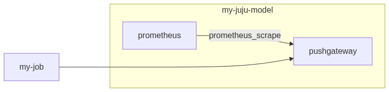

B. Using regular HTTP request
The second alternative to send metrics to Prometheus through Pushgateway is by performing a regular HTTP request. Let’s say we have a Juju model in which prometheus and pushgateway charms are running and related through the prometheus_scrape interface. Outside that Juju model let’s imagine we have a batch job that produces an output in which are metrics we need to send to Prometheus.
my-juju-model  microk8s    microk8s/localhost  3.1.5    unsupported  16:02:48-03:00
With a simple bash oneliner we are able perform a HTTP request to send metrics:
$ echo "messi_world_cups 1" | curl --data-binary @- http://10.1.38.97:9091/metrics/job/my_batch_job

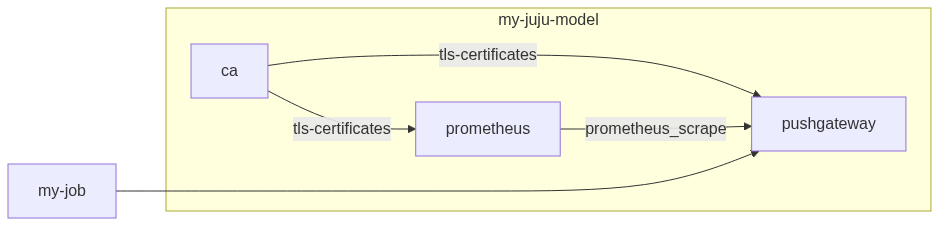

2. Send metrics over HTTPS to Prometheus through Prometheus Pushgateway
In the previous section we have explained two alternatives to send metrics to Prometheus through Pushgateway, but both are done usign non-encrypted connections. Now it is time to improve both alternatives by using an encrypted connection.
In order to achive this, we need a Certificate Authority charm to provide certificates.
Based on what we have explained in section 1.A let’s say we have added an extra charm ca (self-signed-certificates) with the following charms and relations:

B. Using regular HTTP request over HTTPS
Based on what we have explained in section 1.B let’s say we have added an extra charm ca (self-signed-certificates) with the following charms and relations:
my-juju-model  microk8s    microk8s/localhost  3.1.5    unsupported  17:10:37-03:00
ca                    active      1  self-signed-certificates    edge      36  10.152.183.71   no
ca/0*           active    idle   10.1.38.94
ca:certificates                prometheus:certificates        tls-certificates   regular
ca:certificates                pushgateway:certificates       tls-certificates   regular
With a simple bash oneliner we are able perform a HTTP request (over HTTPS) to send metrics:
$ echo "maradona_number 10" | curl -k --data-binary @- https://10.1.38.97:9091/metrics/job/my_batch_job
